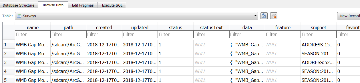

I've considered editing the SQLite file and changing all the add entries to update entries in the 'status text' field but this seems a little dangerous.
Is there a smart way to force a resubmit of all sent surveys?

As you suggest, the only way I can think to bulk update and send allt he surveys would be to edit the sqlite database and all the records at once, remove the tag marking them as Sent, and mark them as Outbox, edit the values that need changing, and then from Outbox submit them all in one go.

I edited all the status field entries to 1 (1=outbox, 2=sent) and it seems you also need to null the status text column as well (took me a well to catch onto that). You can select multiple rows at once and then right click to null or paste values so this is quick for hundreds or even thousands of records.
I then copied the database back to the survey123 databases folder on my desktop machine and saw that all the records were now in the outbox, pressed send and job done.
