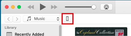

Hi Dionisio,
After connecting your device to iTunes, do you see the icon that represents the device?
Click on that and you should see file sharing in the menu on the left.

Hi Dionisio,
