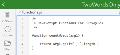

A couple of ideas:
  • Use a regular expression in the constraint column. For example regex(${input_text},".[,].")
  • Use a custom JS function to define the logic of your text evaluation. For example, you could use split on your input text to check if the array with a comma separator has two entries
Attaching both options so you can see them in action. Start with the RegEx one. It is simpler.

A couple of ideas:
