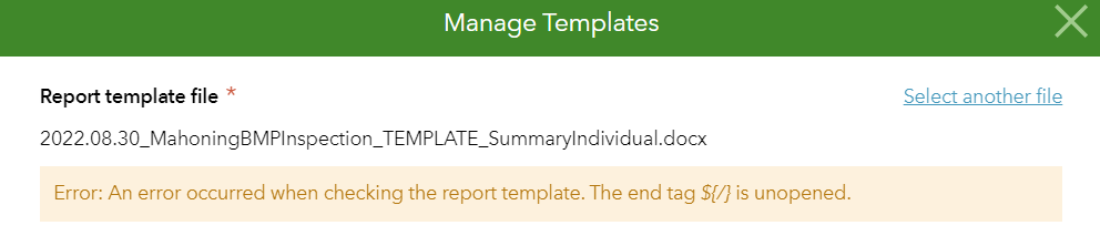

I am creating a report for inspections done in Survey123 and I keep receiving this error every time I try and upload my template:
My template includes a summary section followed by individual records. To try and isolate the problem, I copied each section into a new word document and tried to upload just the summary section as a template, and just the individual section as a template. Guess what... they both worked on their own! So I'm not sure why they aren't working together in one document.
I am attaching my report template. Any help is appreciated!
Hi Kristin, We ran into the same error recently and the 10/31/22 Survey 123 browser upgrade appeared to resolve our issue. Not sure if you've tried running this report again since Halloween, but am curious to see if that was the fix for you too.

Hi, I am encountering same issues you and when you and Kristin reported with the mysterious "end tag ${/} is unopened" error message. Can you tell m more about the 10/31/22 Survey123 browser upgrade you mentioned that appeared to resolve the issue for you?

I am having this same issue. Have you managed to find a solution?
@SeanNagy1 - As dumb as it sounds, I believe I just copied the Summary section and the individual records section and pasted them into a Word document. For some reason I believe that fixed it.
