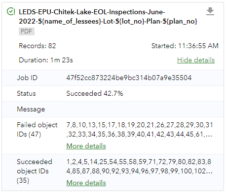

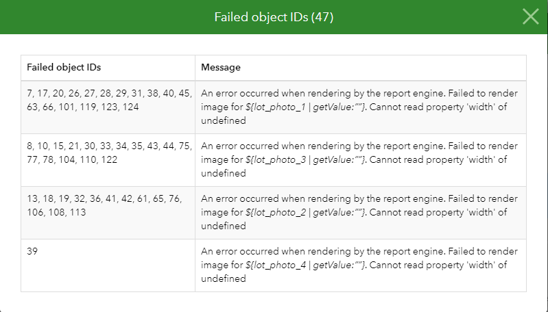

I'm having trouble generating reports using the report generator. The generator produces reports for about half of my records and the other half I get the following error:
I cannot figure out why some records it produces the reports but not others. There doesn't seem to be anything wrong with the photos. I really don't want to have to produce these reports manually...
Upon some further digging it appears any user who isn't myself (owner of the survey) the photos do not want export during report generation. I can see all of the photos on the survey123 website for each response for every user. Is this a permissions issue on mobile devices or sharing issue on feature services perhaps?
