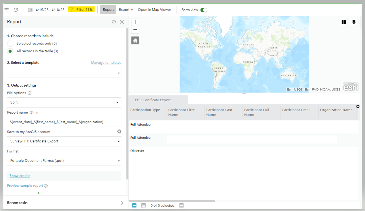

Essentially what I'm aiming to do is create a scenario in Make that replicates this process where you can filter for specific records (parentglobalID in this case), then generate individual reports for each record with the filename tailored from the attribute table:
The screenshot above is from the survey I created specific to the Attendance repeat, however if this process can be achieved via the parent survey, that would be ideal.

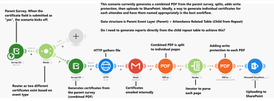

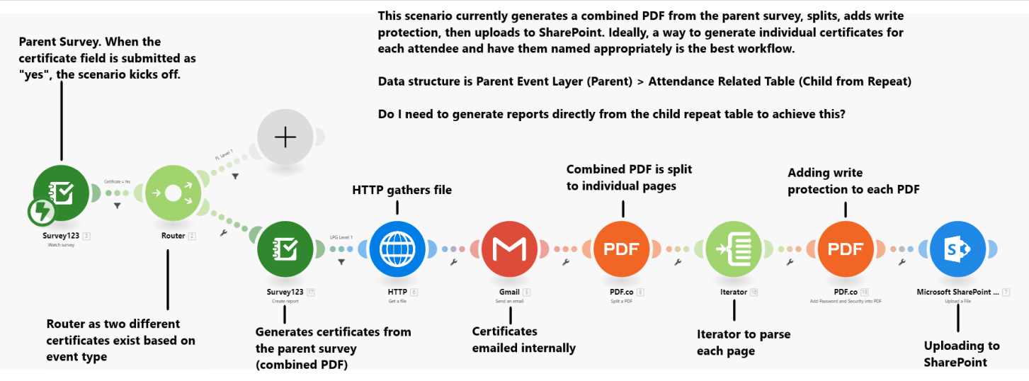

For additional context, here's the current scenario I have in Make that gets me 90% of the way there. The last 10% is having it so that PDFs have custom filenames based on attendees, but I feel incorporating that last 10% will require changing the entire process.
