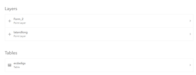

Greetings,

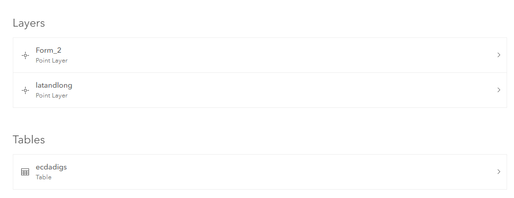

I have a survey form that leverages a repeat to capture inspection information, and each inspection requires an embedded repeat that captures two sets of latitude and longitude coordinates.  When I submit the form the resulting feature service (hosted) contains 2 layers and one table.  One of the layers contains the captured lat/long values (from the nested repeat). The other layer holds the information captured in the survey that is not within the repeat group.  Finally the table contains the information captured date from the survey repeat.
I want to create a web map that will show the captured lat/long points but also configure the pop up to display the values from the table.

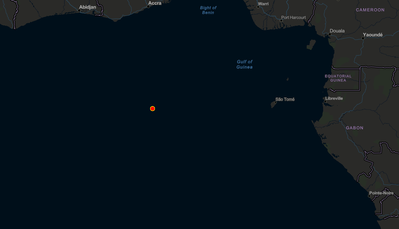

2.  There is a section in my survey that captures data outside the repeats. I configured the survey form this way so specific information needs only to be input one time by the user. That information applies to to each set of collected data in the repeat, there is no need to capture spatial information for that general info, but I am still getting a point layer for that section.  Is there a way to disable that so I am not getting a random point on my map that is showing up some distance south of Ghana in Africa?

But for the 0,0 all forms have GPS.  They have to be be a Feature layer.  So if you hide the spatial at the root of the form then they all get 0,0.  I would not hide it.  Knowing where they were when they used the form is always handy.  We see users in the wrong spot all the time.
