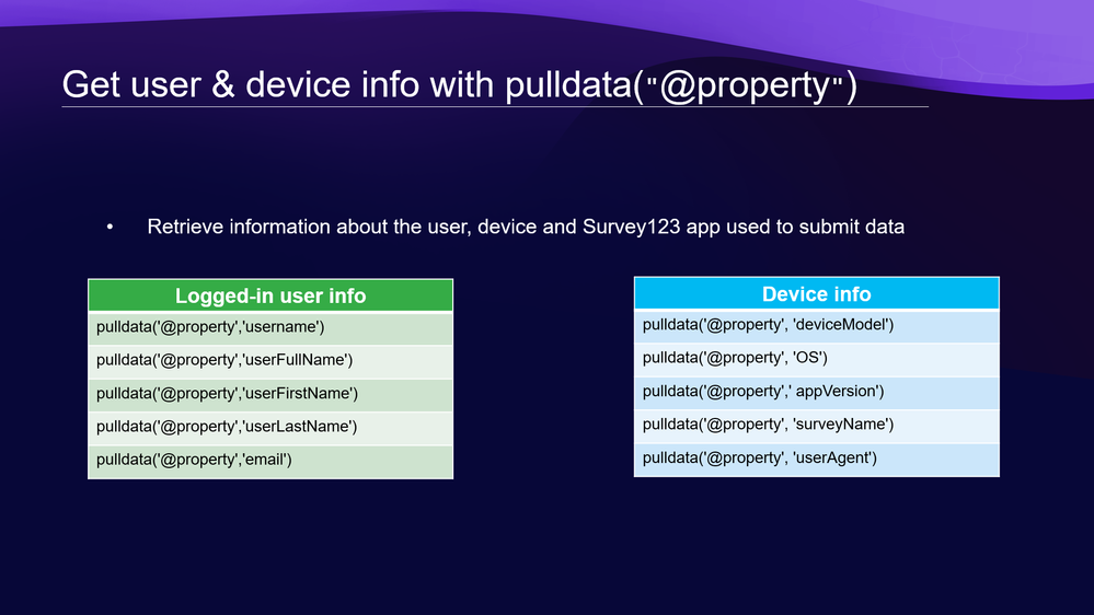

Alternatively, you can also use pulldata as shown below. Also attaching an XLSForm to this message.

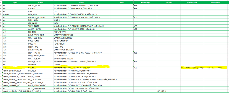

Below is what I have currently! Do you see anything that I am missing?

I'm having the same issue.. the
 - pulldata("@property", 'username') in the Calculation field works fne for me, but if I change it to..
 - pulldata("@property", 'userFullName') then I get the same mesage on my form as Jordan has described.. i.e.
Unknown @property: userfullname

@DfIRivers  @Anonymous User  For the Unknown @property: userfullname error, I bet the problem is the version of the Survey123 app used.  If you install the latest version it should work.
Older versions of the app do not support userFullName.
