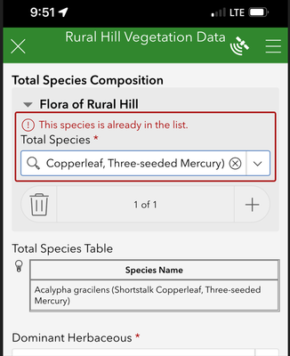

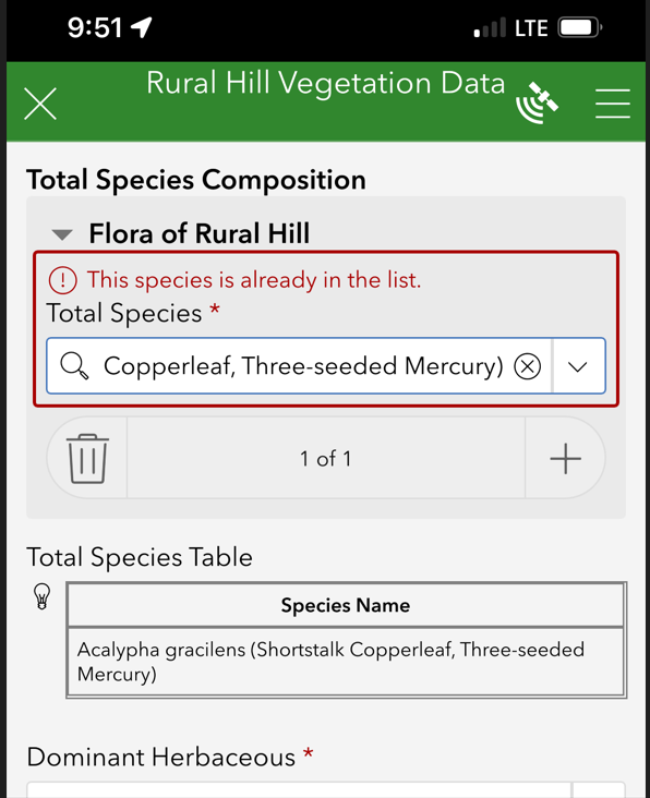

Repeat not working correctly
952
06-24-2024 07:17 AM
Damian_Smith
Just received the following error on survey which uses a series of repeats and related tables. I'm inheriting this survey along with a number of other, could use some advice as to what might be the underlying issue? I waiting to get access form, but I assume based on experience it maybe a simple fix.  Any suggestions would be much appreciated, as I haven't run into an issue like this before
DougBrowning
MVP Esteemed Contributor

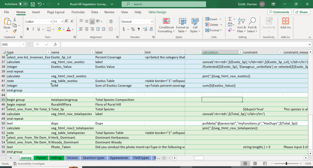

This looks like my trick to check for dups.  This did break recently.  See this post for how to fix.  https://community.esri.com/t5/arcgis-survey123-questions/repeat-duplicate-preventer/m-p/1155978
I would also get rid of any commas in that list.
Hope that works.
Damian_Smith
I just got access to the form late yesterday. It is a duplicate checker, the original author used JavaScript using the @pulldata function in a hidden text field  to check for duplicate. I looked at your repeat duplicate preventer, I think that might work. Just in case it won't, I've attached the XLS form, if you have chance to take a look at the Form itself. Which I updated from an outdated form Version to the latest version
