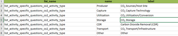

Your list names are crazy long and probably hitting a limit  list_activity_specific_questions_co2_producer_activity_status

Oh also a good chance it does not like these special chars here on the 2.  I would remove those as they will not store correctly anyway.  Good idea to never use special chars like this.  Happens a lot. The error is saying it is this question so good place to start.

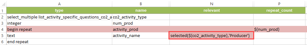

Hi @jbauer I'm able to reproduce the issue you are experiencing with a survey I published  with your XLS form. It seems like the error is reproduced when a repeat with relevant expression has a dynamic repeat count. For example, there is a repeat in your survey called "activity_prod". This repeat has a relevant expression "selected(${co2_activity_type},'Producer')" and the repeat count is determined by another question ("${num_prod}").
Removing the calculation for the repeat_count and replacing it with a number resolves the issue but it may not be a viable workaround.
On the other hand, removing the relevant expression for the begin repeat and adding it to the questions inside the repeat which also resolves the error might be a better workaround for you.

Hello. I have noticed that I had the same error, I detected that it was caused by the combination of relevant and repeat_count in the same repeat question.
It seems that the relevant process cannot be combined with the number of repetitions in the same field when using it at the web.
