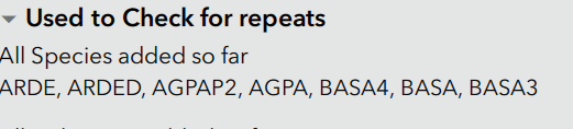

You get around this by adding a comma on the search string as well.  Maybe the latest one I did not post.  The latest version did change it a bit.
Do you have it like this  not(contains(${AllPlantsCheck}+",",${Species}+",")))

Yes, That is exactly what I have. It works great unless they enter them in out of order. It is throwing me for a loop.
if(${TempCount}=0, 1,${structurecode}='' or not(contains(${AllGridCheck}+",",${structurecode}+",")))
