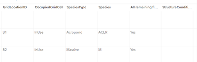

@DougBrowning  So that did work but upon testing I noticed in my feature service that my repeat is now creating a 1st blank entry before they add the first repeat So it will be blank entry (see image), then Grid B1 (1st repeat), B2 (+ repeat), B3 & send. Any idea what could be goin on here? Thanks again!

I have seen it creating blank records at times.  Mostly it was using hidden and I think the appearance of minimal or some combo.  Its been so long I am forgetting what we tracked it down to.  We never did get rid of them though.  I do not think it is the dups code I think it is something else.  Mess with minimal so that you see a + sign vs it auto loading the first record and see if that does it.  If you are using the esri visible try a change to relevant.
Hope that works
NatalieSlayden
I am going to give some things a try. I think you are totally right tho, not necessarily the dup code. Looks like a bug that has been around for awhile after further research. Thanks as always! Your responses are always so helpful!
