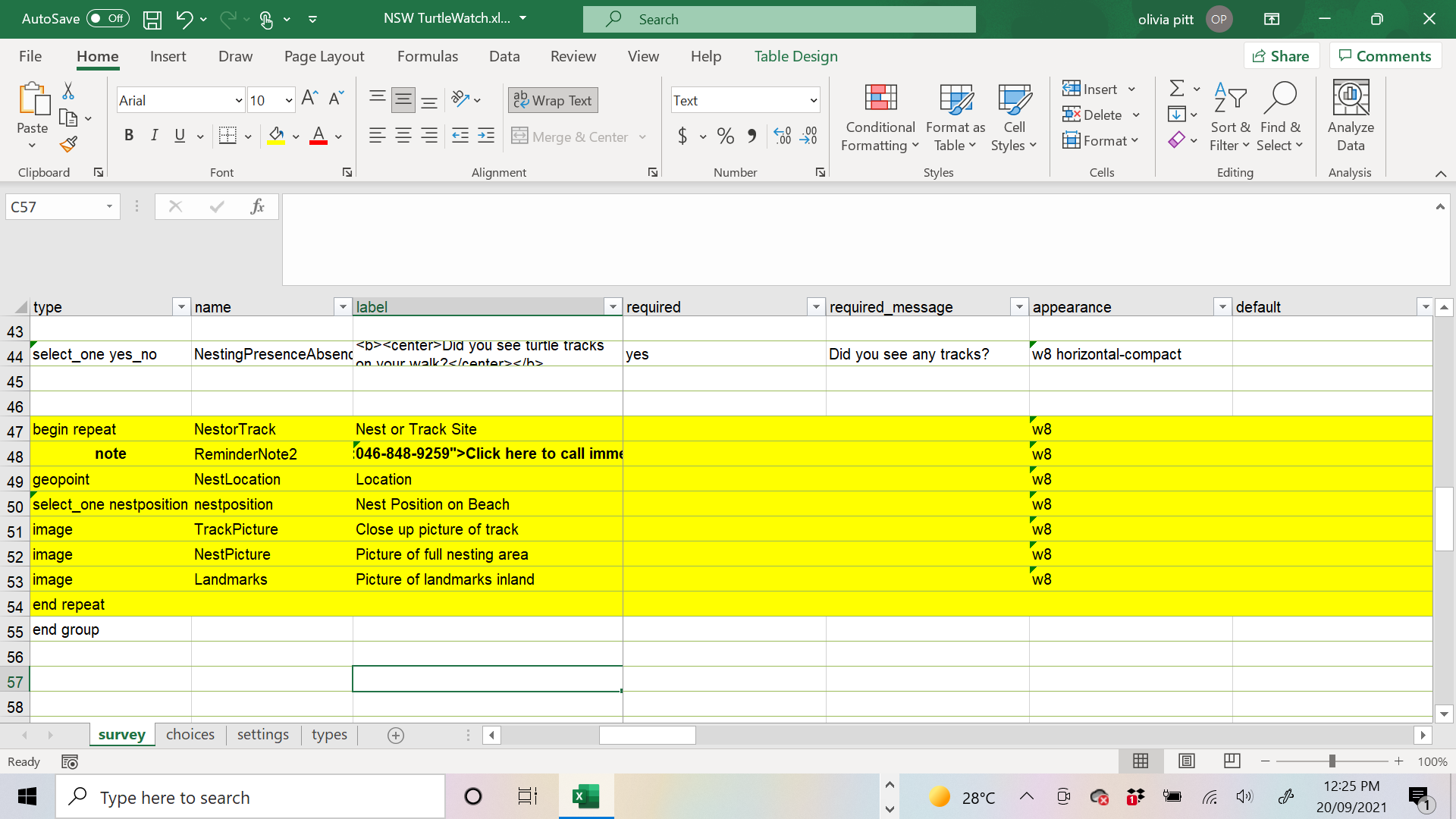

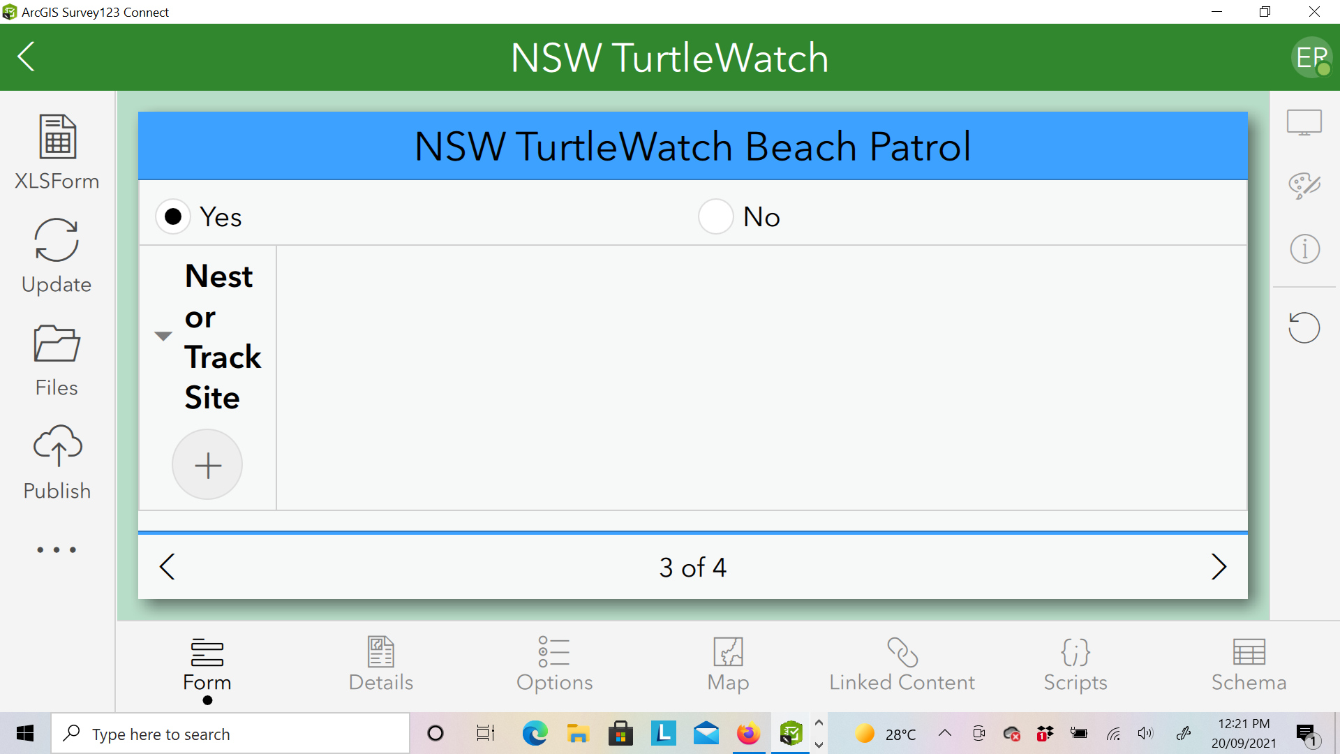

Hi, I created my App a year ago and it was working great. Just opened it for our next season of data collection and one section is not displaying properly. It is a 'repeat' section and will not display across the entire screen, only in the first column, shown below. Even though I have 'w8' in the appearance column, area highlighted in yellow does not display properly.
Disclaimer: I'm a biologist so don't know the technical terms but App worked great for our first season of data collection.
Any help would be greatly appreciated.

The problem is related to setting the group that the repeat is within to w8. In 3.13 we fixed a few bugs around grid theme and repeats not honouring the width set by the parent group. In 3.12 or earlier, repeats always took up the entire row (filled the width) and ignored the value applied to them or coming from the parent group (in your case w8).
Now, in 3.13, repeats will honour the width and take up the allocated width as per how other questions behave. If you need the repeat to take up a different width from the default, you can use a group around it to set the correct width.
Without seeing the rest of the form, from the screenshot, and the different groups and repeats used, it is hard to say exactly what you need to change to fix it. If you could share your XLSForm (xlsx file and any files from media folder) and we can take a look and help get your form working as expected again.
