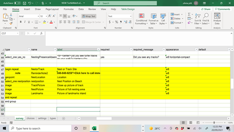

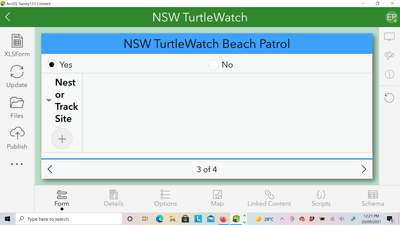

Hi, I created my App a year ago and it was working great. Just opened it for our next season of data collection and one section is not displaying properly. It is a 'repeat' section and will not display across the entire screen, only in the first column, shown below. Even though I have 'w8' in the appearance column, area highlighted in yellow does not display properly.
Disclaimer: I'm a biologist so don't know the technical terms but App worked great for our first season of data collection.
Any help would be greatly appreciated.

Thanks for sending me your XLSForm. It appears you were setting the group for those pages to w8, however every question inside that group and the nested repeat were also set to w8. Meaning that everything inside this page always takes up only one column. In that case you should set the page to w1, and then every question and the nested group will also be w1. The outcome of this is that it looks the same as it did before. You can then use a nested group inside the repeat to set a different number of columns, as you have done with the other page.
As described in other comments, the reason his has changed in 3.13 compared to 3.12, is we fixed some issues with nested groups and repeats in grid theme, but in some cases it causes the nested groups and repeats to only display in one column, as that is all they should occupy by default. We updated the blog post about groups and grid theme to reflect this change.
One thing I noticed is that some of your questions and notes do not have a w appearance. With grid theme you should ensure every question has a w appearance, to ensure it displays correctly. Some of your notes only take up one column, and other questions only half the columns, but there is not another question of same width next to it, this kind of looks odd. I would suggest to update this in the form, make every question have w appearance, (including notes, hidden etc) and also make sure you use the lowest dividable numbers for the total columns you want on the parent groups.
I also noticed for some of your other pages, you set w8 for the parent page group, and then use w4 for individual questions inside it (end result is two columns). Why don’t you use w2 for the parent, and then w1 for the questions, the layout will be exactly the same, but less grids/columns are being created behind the scenes.
