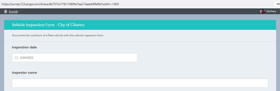

KateDoughty1
But I'm not embedding it - just providing the URL so I'm not seeing the option to modify.
ZacharySutherby
Hello @KateDoughty1
The width URL parameter isn't exclusive for embedding surveys, your can append it to the URL you are providing and when a user opens that URL they will see the wider form:
