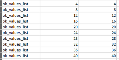

Being frustrated in the past that Suryey123 did not appear to support this type of thing, this is what I came up with:
1. Add a select multiple where the default value is set to include all the valid choices.  Set the body::esri::visible to hide this question (use something like 1=2), and set the bind:esri:fieldType to null so that no field is created in for this.
2. use the formula: selected(${multiple_selection_question}, string(${TRANSECT_NUM})) in the relevant.
Here is my tested and functioning sample:
Of course you need the choices:
This approach can easily be reused, although it is relatively static, if you needed to generate the valid choices on the fly, you might need a very long choice list or external csv.
