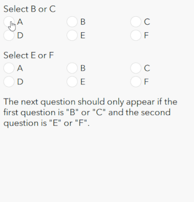

I don't see why this wouldn't be as simple as adding parentheses.
(selected(${question1}, 'B') or selected(${question1},'C')) and (selected(${question2}, 'E') or selected(${question2}, 'F'))
- Josh Carlson
