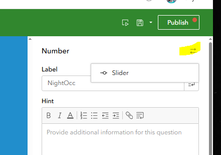

I'm working on a survey and I want users to have some radial select ("Single select") questions where the options are Yes, No, or Unknown. The responses should write to a field in an existing feature layer.
Right now, I only see the "Slider" as an alternative option when the field is an integer. I've tried with string fields, but only see the "Singleline text", "Multiline text", and a few other unneeded options. Do you know how I can see a  "Single select" option when I drag in a field?
Below is a screen capture of the options for an integer field.
I want to have a "Single select" option where the results write to a field. I'm working in survey123.arcgis.com.

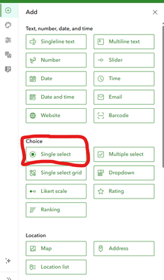

Is this not available to you?  There should be an option in the choice section for Single Select.
ellipsol
It's available yes, but I can't seem to get it to populate an existing field in my feature layer.
I try to reverse engineer it by first adding the field to the survey, but I don't see a "Single select" option.

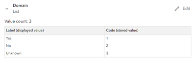

ellipsol
Thank you for your efforts. I had created a domain for the field, but at your suggestion, I re-created the form using that layer. I still don't see the "Single select" option for that field. Below is my domain.
Neal_t_k
MVP Regular Contributor
@ellipsol strange, when I test it after adding a domain and refresh appears automatically as a single select.  What does it say for that field on your schema page.
ellipsol
Oh you did a string type, I will try that.
ellipsol
That did it, using a string field! Many thanks.
