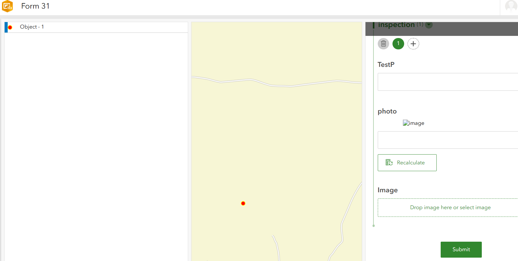

We are facing an issue while pulling images in Survey123.
I have created a new survey form that contains three questions, including an image question, along with repeat questions for an inspection workflow. The workflow is as follows:
  • A surveyor conducts a pole survey, collects details, and captures photographs using the first survey form.
  • At a later stage, a senior user conducts an inspection survey using a second form.
  • Some details from the first survey are populated into the inspection form.
  • The senior user reviews these details, including the images, and then provides approval.
However, the images captured in the first survey are not displaying in the second (inspection) survey form.
I am using URL parameters and have embedded the inspection survey form in a Dashboard. Both survey forms were created using Survey123 Connect

Where is the image question for each user, your description sounds like your initial image question is outside of the repeat in your main form, however in the screenshot provided the image question appears inside the repeat.
If it is inside the for both, do you have "query allowUpates=true" in the bind::esri:parameters column of the image question.
If the original image question is outside the repeat, you will have to perform a calculation to populate the image inside the repeat.  However if you are using a Dashboard, you could make a list element to view the images and not try to move them around in the survey.

We have a hosted feature layer consisting of a point layer and its associated related table.
The images are stored as attachments on the point layer, while the inspection Survey123 form is created on the related table.
We also attempted the following:
Calculating values from the point layer in Survey123 Connect
Creating a new question of type "note" to calculate and display the image in the inspection survey form
In all cases, the image fails to load or does not render.

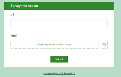

Did a quick test and this should work.
Workflow:
Created and Published a survey with a Main section with an image and questions all relevant,  With a repeat section with inspection questions, not relevant, reserved for later.
Copy form1 to form2, Make the repeat section relevant. Make all questions but the image and any other identifying information not relevant in the main section.  Set the submission id to the url for the feature layer of form1. Publish.
Submit an image and answers in form 1.
Configured a url for form2 using the globalid from the submission to form1 to open form 2.
The image was visible.
