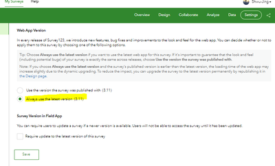

Hi Jim,
Could you check your surbvey Setting page to see if you are using the latest version of web application?
This issue has been addressed in the latest hotfix and if you set the version to the latest, you should not see this issue anymore.
Could you check your setting for the survey to see if you had chosen to use the latest version?
