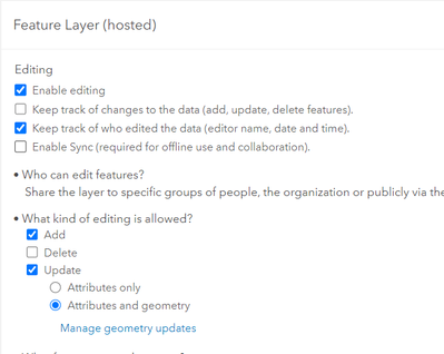

Yes, it does. I have just replicated the whole issue from scratch. I can now say that this happens not only when you open a survey in mode=copy, but in normal mode as well. Attached you can find the 2 JSON files that define the services for the Layer and the View Layer, plus the XLSForm.
Summary of the process followed:
- With Survey Connect, create a simple survey from the "Advanced" template. Remove the "select_one" question. Add a new "file" question. Publish the survey. Switch to AGOL.
- Share both the survey and the survey layer with the Organization. The survey layer settings are not modified (see attached file: "Survey_Layer_Settings.jpg")
- Create a View Layer from the survey layer. Add a filter: "Example text question = 1".
- Share the View Layer with the Organization.
- Change the settings of the View Layer (see attached file: "Survey_View_Layer_Settings.jpg).
-  In Connect, point the survey to use the View Layer.

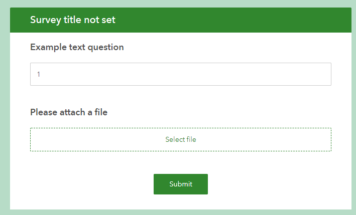

- If a user other than the owner attempts to submit a survey with BOTH:
  • A value for "Example text question" other than '1', and
  • A file attachment
    ...then they get this error:
Other combinations work fine (for instance, user introduces '1' to the question AND attaches a file, or introduces '0' to the question BUT he/she does NOT attach a file.
Note that now we are not opening records in copy mode, but simply submitting a new survey.
The error can be avoided as well if "Editors can edit all features" is enabled in the View Layer (this is not an option for our scenario).
