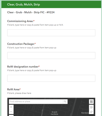

I have a survey published from Survey123 Connect.

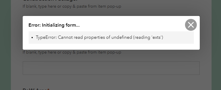

It opens fine in the Survey123 application, but when one tries to open it online in a browser the following error occurs.
I've also attached the XLSX form the survey was published from.
Has anyone else had similar issues? If so, any suggestions on how to fix?

I wonder if it doesn't have something to do with the commas and quotes in your choice list names.
 I removed the commas and quotes in your choices and also the commas in your survey name and republished and it seems fine on Survey123 Web:
