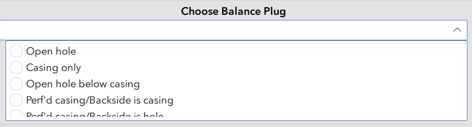

I am running into a very strange occurrence where questions using a choice_filter are showing the same choice list over and over.  All users on Android, Apple and Windows field apps are experiencing this problem.  We do not utilize the web app.  Here are some screenshots showing what is being experienced.
Top of list in Picture #1

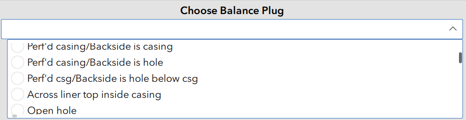

Start of same list a second time in Picture #2.  Notice "Open hole" appears again.
In this instance, the entire list repeats 4x.

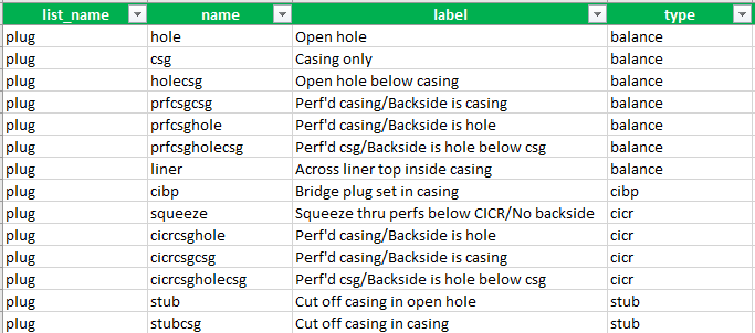

Screenshot of choice list
In this case, the choice_filter "type" used was balance.
From what I can tell based on my experience and others, the list replicates each time a survey is submitted.  The problem goes away when deleting the survey off the device and re-downloading it.  Does anyone have any idea what would cause this and has anyone else ever experienced it?  I have searched for days and have had no luck.  I will add, this is the only survey that experiences this problem, so I am sure it has to do with how I have things setup.
