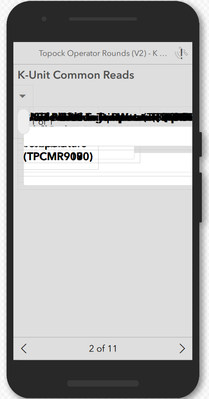

Hey all,
I am having a hard time figuring out why my form is not accepting the format of "pages theme-grid" when I use the repeat sections. The image below shows how it is the appearance of one of the sections I create.
I have attached the survey below (It is a pretty long survey).
I have tried creating a group inside the repeat and outside of it, changing the appearance, and many other things.
Anyone that could help me?
AnaDeniston
The solution was to write the appearance for each repeat w9:9.
from esri support: "Please keep in mind that when working with nested groups and repeats in grid theme surveys, you need to specify not only how many columns you want for questions within a group, but also what you want the span of the group to be within its containing group. This is accomplished through the following syntax: w<columns>:<span>. Please see Survey123 Tricks of the Trade: Groups, Grids and Pages and Appearance—ArcGIS Survey123 for more information about this."

I took a quick look at your form and I think the issue is the appearance value for your page group. At the moment it's field-list w9. If you change that to just field-list and then create a group immediately inside your repeat with an appearance of w9 that should work. So:
Rather than:
I attached an updated version of the xlsx that's working on my system.
Hope that helps
