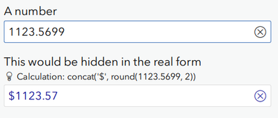

With this in the constraint column:
$00.99;_
The form looks like this:
Clicking on to the question and typing "1234" fills it in, keeping the other characters.
For larger values, you can just extend the number of 0s before the decimal. When filling in the question, typing the "." character jumps the input to that section of the input mask. Pictured below is the result of me typing "100.30".
The form automatically strips blanks form the input, too!
$00.99;_

What about having the form prompt the user for a numeric value, then just pipe that question into some text that's submitted to the data?
