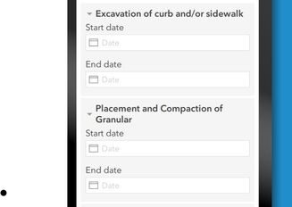

I am looking to organize the start date and end date side by side for a survey in Connect that will be used on a smartphone primarily. I believe I need to set it up grid style but can't seem to figure out how to do that. Can I edit what I have or do I need to start it over. Can someone explain or show me a simple XLS so I can clarify?  Thanks in advance. **The picture below is what I currently have.

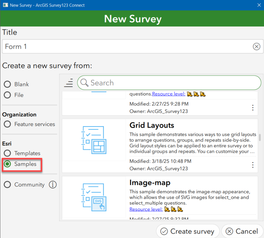

Adding on that there are a ton of sample available in Survey123 Connect showcasing a variety of functionality, including grids.
Create a New Survey > Samples
Samples in Survey123 ConnectSamples in Survey123 Connect
