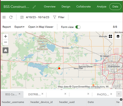

Sorry, when I said "I don't believe so", I was thinking about your comment of only the first x,y plotting in the dashboard. I thought that was expected behaviour where S123 only plots the first location. James talks about multiple geopoints here. Essentially, you use calculates (like I have above) to extract the x,y data from all of the geopoints. You should be able to get these multiple points to plot on a regular web map, but, again, I don't believe it's possible to have them all plot onto the S123 dashboard*.
Esri support is correct, you can definitely have a geopoint inside of a repeat.
*By "dashboard", you mean this, correct?
