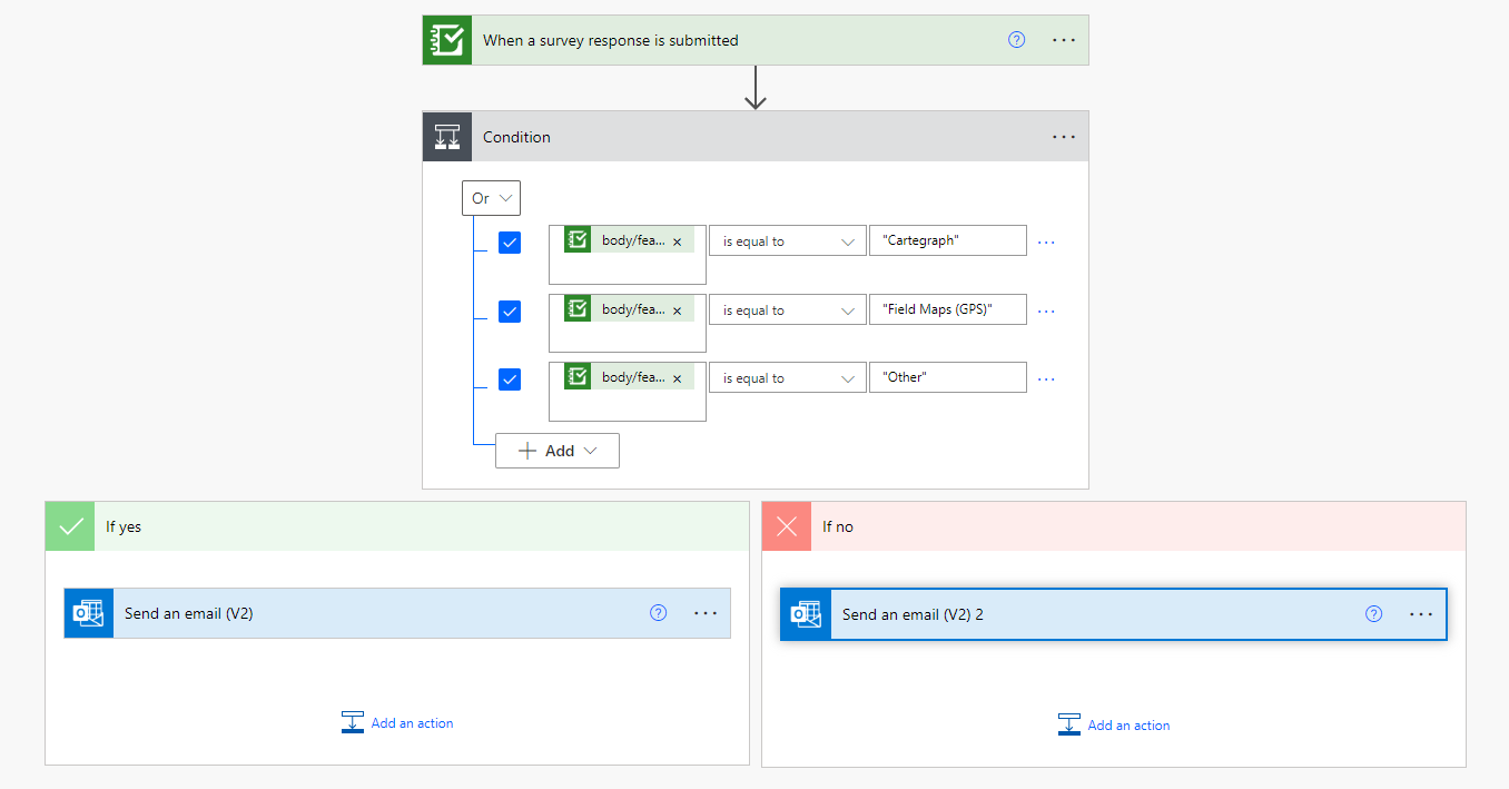

I am trying to set up a Power Automate flow that will send an email based on a selection in the survey.
Essentially:
- if someone submits a survey with choice A, B, or Other selected, I want it to go to person 1
- if someone submits a survey with choices C, D, or E, I want it to go to person 2.
I was trying to do this by setting up a condition where if the question choice is A, B, or Other, it matches with Yes and sends an email to person 1. If none of them match, it goes to No and sends an email to person 2.
I assume this has been done before, I just can't find any documentation on it. Any guidance or articles would be greatly appreciated!
Here is an image of what I have so far - no test submission has made it through.
SarahRijneke
Have you tried to remove the quotation marks? I have a survey123 flow that works without them.
SarahRijneke
leahmaps
That worked, thank you!
