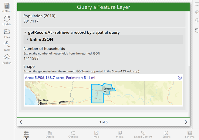

This is possible using the pulldata("@layer") function to query the feature service for the geometry then populate a geoshape question with it.
Please check out the Query a feature layer sample in Connect on the third page there is a section that shows populating a geoshape question using pulldata("@layer").

mshanaghan
Yay! Thank you! I got it working.
It is unfortunate that that feature is not supported in the survey 123 web app 😞

This feature is supported in the web designer and the web app. Please see the pulldata("@layer") Esri Community blog for more information.

Oh okay. I only questioned it because this was in the "Query a feature layer" sample:
"Extract the geometry from the returned JSON (not supported in Survey 123 web app)."
