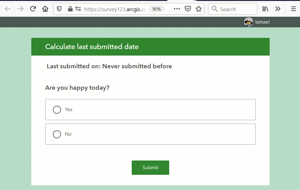

Hi @dgray  Attached is a solution with a custom JavaScript function. Basically, I query the feature layer of the survey to retrieve the newest record submitted by the currently logged-in user and I get the submission date of the record.  The form assumes that the user is logged-in and that Editor tracking is enabled in the layer.
  • Use the Create Survey from File option to import the XLSForm.
  • Copy the scripts folder into the survey directory
  • Publish the survey and submit records to see how it works.
I hope it helps.
