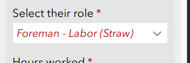

Okay, so I now have it mostly working.  I didn't know the file needed to be in the media folder.  My only issue is that even though the looked up value is in the CSV as an exact copy as the lookup from the XLSForm, it's throwing an invalid value error.  See this screenshot.

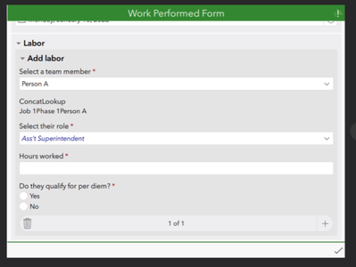

Ok, so I downloaded the attached version of the Survey and CSV, and set it up on my machine with Survey123 Connect v. 3.12.232. It seems to be working fine for me: when I choose values from the dropdown, the role auto-populates with the text in blue:
If I manually change the role after that, the text changes to black (which implies it should still be a value that the survey will accept).
Do you experience different results when you test the survey in Connect on your machine?

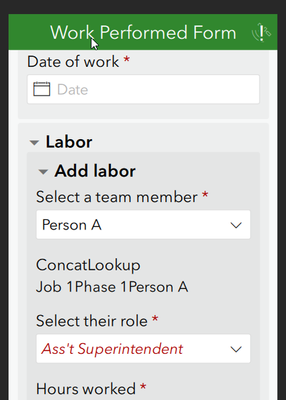

I'm on the version Survey123 Connect Version 3.13.251 (maybe it's a version issue?) , and am getting red text when I go through the same procedure you listed above.  See this screenshot:
