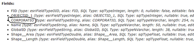

I've been working with the pulldata @layer, but it returns nothing,  the layer is shared publicly, the url is correct i get no error on the syntax of the calculations, what am i doing wrong ?
ZacharySutherby
Hello @KevinNoelUWI2022
Looking at the REST endpoint of the feature service it looks like the field you are trying to extract the attribute from is all caps:
In the screen capture of your XLSForm only the C in the field name is capitalized. If you switch your syntax to attributes.CORPORATIO does that bring the attributes in?
