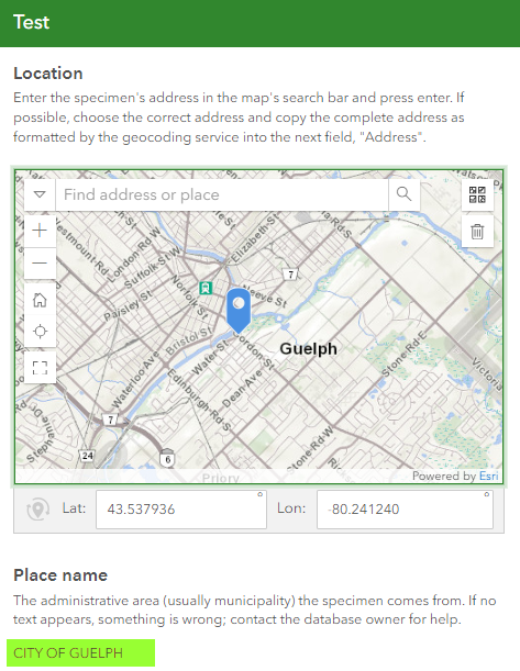

Things are working great in the web version of Survey123 - if users choose to fill out the survey online using Google Chrome, all works as expected. I originally had an issue where some municipalities were not being retrieved, but solved this with the addition of "?returnGeometry=false" in the pulldata line.

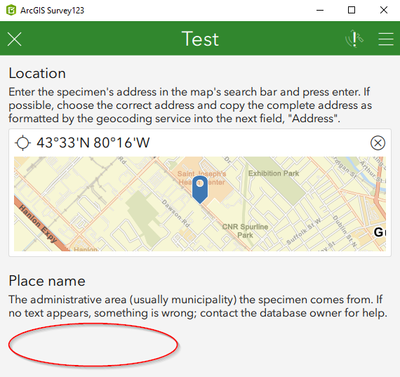

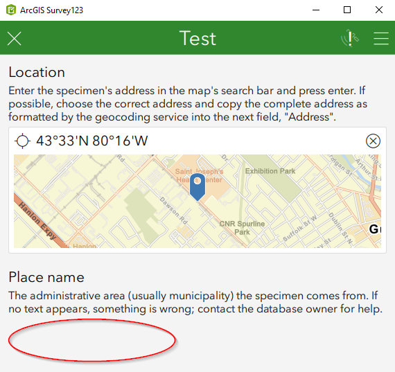

City of Guelph is populated in Web App:
Unfortunately, in the mobile version of Survey123 (IOS) and Windows Desktop Survey123, "City of Guelph" is not being populated (along with other areas):
I've attached a reproducible example here for troubleshooting. Hope someone can help me figure this out!
