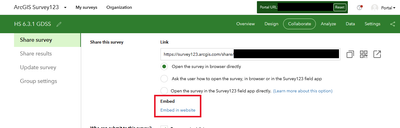

Are you looking to embed a Survey123 form inside of a pre-existing web page?
If so, do the following:
1. Go to the Surveys Site
Surveys Site can be accessed from: https://survey123.arcgis.com/?portalUrl=YOURPORTAL
YOURPORTAL
is the URL used to access your organizations Esri Portal.

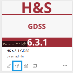

2. Locate the survey and click on "Collaborate" icon
3. Look for the "embed in website" button
