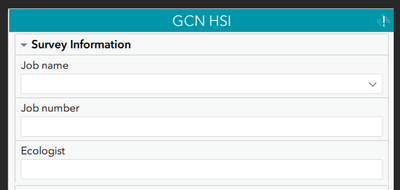

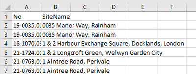

BenBlowers2
Hi Alfred
It is just a "text" question I am trying to populate. Sure, please see attached screenshots.
Basically, I am using the search appearance to pull through the job names from a linked CSV, but then I want to use the pulldata CSV to pull through the corresponding job number, which is also stored in the CSV.
Thanks,
Ben
AlfredBaldenweck
MVP Frequent Contributor
Something else I noticed that might be causing issues is that your CSV doesn't have a  set of "name" and "label" columns.  I think pulldata() requires both to work, while search() appears to only care about the columns you specify.
