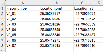

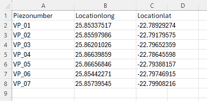

and this is my CSV table located in the media folder.
Whenever I select one of the list's choices, neither of the two pulldata() fields fill with the lat and long.

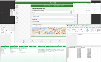

Ruth_JiatengXu
Hi @RemyOlive
I created a survey based on your screenshot, and it worked for me. The XLSForm and csv file are attached to this post.
Could you please try my form in your Connect or share your XLSForm with us?
Thanks,
Ruth

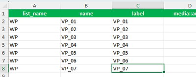

abureaux
MVP Frequent Contributor
Your CSV is wrong.
The "name" and "label" columns are required, just like on the Choices tab.
EDIT: For clarity, the screen shot above is from OP. Here is an example of what it should look like (note the addition of the "name" and "label" columns):
