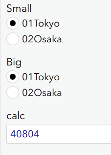

There should be no need to set type.
As you can see in this simple test, the values are nativity interpreted to be numbers. If they were a string, the values would be appended to each other rather than added together.
