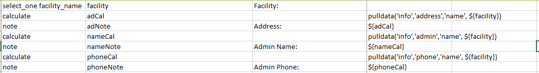

It seems as though my pull data is not recognizing that there is a CSV file in the Media folder. I have been looking for a solution for sometime, I have tried remaking the csv and making it fresh along with following various pulldata() creation tutorials and I simply can not find where the miscommunication is.
pulldata('Info','address','name', ${facility})
name address admin phone
place_name 1234 fairy rd Bob Frank 800-867-5309

I suggest checking if the name of the csv is exactly the same (uppercase and lowercase letters) as the one you put in the pulldata() function. Check the field names as well if you can.
Would you mind sharing a screenshot of your csv? Just the headers and some example data.

Ill double check the cases again.
csv:
