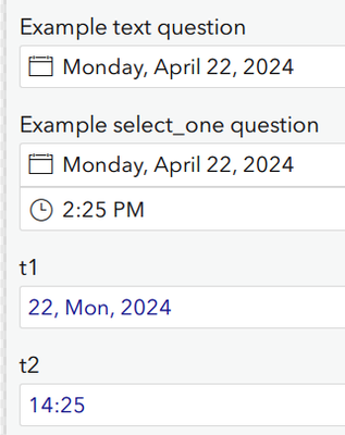

Also, I am wanting to format the date to DD-MMM-YYYY and time to 24 hour time and not quite sure how to do that either as this format-date(${date_capture}, '%e, %a, %Y') and this format-date(${time_capture}, '%H:%M') is not working when I create a seperate calculate type and wondering if someone might know why?
Everything you should need on Dates/Times is in Dates and Time in Survey123. It looks like you have the correct idea already though. When I try your calculates, they work as expected:

Also for the date and time, I just want the date and time (24 hrs) and date (DD-MMM-YYYY) to show not create a seperate field in the survey. Is there a way to do that? Thank you!
Ahhh. So you want the blow questions to display in that format. That is not possible. S123's time settings are unique to the app. E.g., my device is set to 24 hr time and S123 displays 12 hr time.

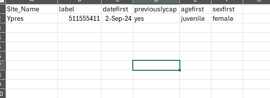

I have seen the link you provided and I still cannot get it to work. It does not autopopulate. My screenshots below. I can't figure out why it's not working.
You need to change the column headers. "name" and "label" are mandatory column headers (just like on the Choices tab of the Excel document).
Have another look at my example:
