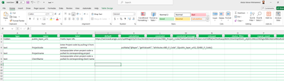

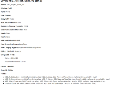

Hi Experts
I have published non spatial table  and generated a token to use it and its looks like this and its publicly shared
Now I want to pull the information from service when searched in the project code with a value available in service and corresponding other 2 fields should be autopopulated when selected or entered
How can i achieve
Service url : https://services8.arcgis.com/opMNag2LPyZVnSsz/ArcGIS/rest/services/KBD_Project_Code_v2/FeatureServer...
Kindly Guide me or correct me with the correction
Highly Appreciate the support @ISM
Attched the xls

My guess is that default values tend to load at the end.  I would try moving the default value in line 2 to the calculation column instead - note you will then probably have to put " " quotes around the URL.  Try that.

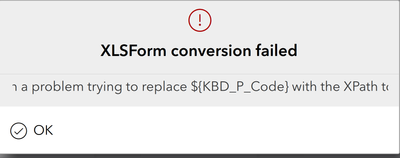

Receiving below error
I'm receiving this error once i moved calculation column and also how can i pull other 2 fields(Client name and project name) based on  project code

You need "" around the URL when moving to calculation.  I attached a sample before.

Hi
I have successfully implemented this scenario but with changes to spatial data feature service instead of hosted feature service table with same fields are there in both
But why it doesnt work with non spatial data because i have list from 2017 to till update which i need to design but hosted service table doesnt work
Is this the issue of authentication , I tried with postman also any suggestion please to correct
