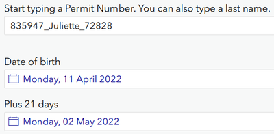

Hi
I simplified it and this is the result:
I hope that is the outcome you were hoping for. Here are the calculations:
pulldata('permits','date_to_pull','name',${permit_number})
${test_dob}+21*24*60*60*1000
The first one is still as you had it but i changed it to be a date type.
datetest_dobDate of birth
The second calculation adds 21 days to the test_dob date.
Hope that helps.

DeonLengton
Hi
Hope that helps.
js80540
Oh wow! Thank you!
I really wish this was mentioned in the documentation, a few other people seem to have the same issue on the forum since the documentation suggest using date().
Thanks again!
