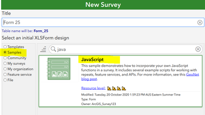

While basemaps in Survey123 are not 'interactive', they can be setup to display additional layers. Yes, it is possible to populate attributes directly from a feature layer using a JavaScript function. I would suggest taking a look at the 'JavaScript' sample available in Survey123 Connect.
There is a group in this sample called 'Working with a Feature Service' that will help you get started. Also check out the 'Working with web services' section in the following Blog:
