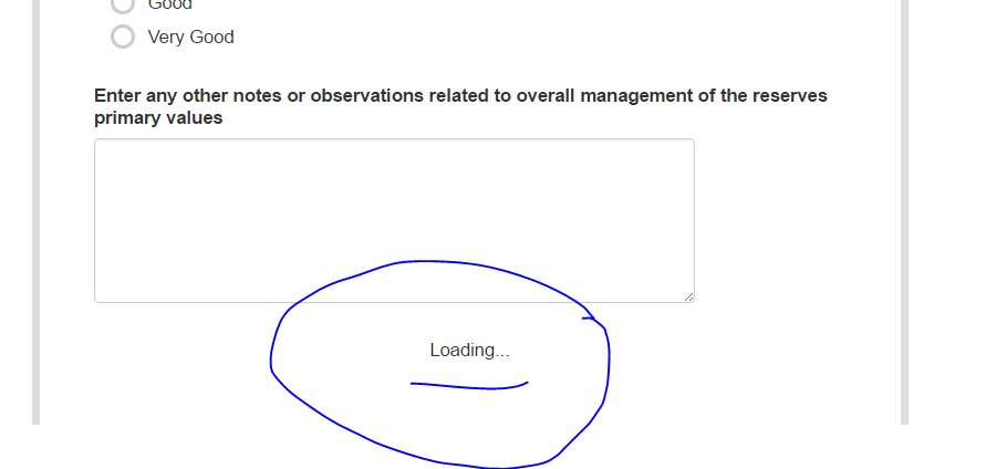

Hello there, are there any known limitations in getting the pulldata from csv function working on a web form? Seems to be functioning well when testing in survey123 connect but after publishing the relevant information is not being pulled into the form. I also can't submit the survey, I get this 'loading' message at the bottom of the survey form. The same form lodges OK from the iphone app (but the pulldata from csv also doesn't seem to be working on the iphone). ?? Thanks

As long as your csv file is stored in the media folder of the survey, there is currently no known issue with using pull data from csv in a web form.
If your issue persists, please contact tech support and supply them with your survey spreadsheet and csv file (or simplified versions of them) so that the problem can be troubleshooted.

The Pull Data function can only be created in Survey123 Connect because the online forms do not yet support this functionality. I've logged ENH-000102972 on your behalf so we can get the error messages improved in Survey123 Online. I know the team is also working on adding more functionality to the online app so it is more directly in line with what is in the desktop application.

Andrew,  the web form you are showing should be able to support pulldata() functions.  This is the next generation webform and is currently in beta- there might be another question that is causing the failure to load.  Can you share the xls file?
