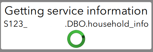

I have a client that has a publicly shared survey through their Portal installation.
I can open and successfully submit the survey through the Survey123 website.
Downloading the survey to a Survey123 client and trying to send a completed survey causes the device to be stuck on the 'Getting Service Information' dialog.
Looking at the diagnostics log file i see the following:
<12>1 2018-03-13T11:22:30Z dlengton Survey123forArcGIS 13532 - [AppStudio@11205 category="default" filename="XFormFeatureService.qml" line="876"] qrc:/qml/XForms/XFormFeatureService.qml:876: TypeError: Cannot read property 'name' of undefined
Any ideas? Is it a field that has a null value but isnt allowed to have one? I'm a bit stumped... any information will be highly appreciated!
JamesTedrick
Esri Esteemed Contributor
Hi Deon,
Can you share the survey and possibly the Feature Service endpoint JSON information?  In particular, the error code you provide indicates something at issue with a relationship.
