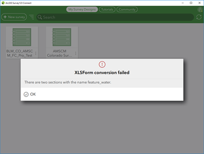

So if I have a survey linked to a Feature Service with the following relationships:
  • Point_FeatureClass related to feature_water table (1 to many)
  • Line_FeatureClass related to feature_water table (1 to many)
When I create the survey, I get the following error:
So to answer your question, yes, there are two repeats with the exact same table name. From speaking to someone from ESRI, I believe the Survey123 design does not allow for this.  Let me know if there's a plan to enable this in the future?  Thanks.
