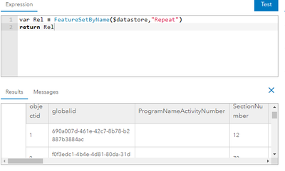

var tbl = FeatureSetByName($map,"service_71239bb2bb8c4d13a46fa8f038cceec6 - Owners");
@AlainMunyaneza1 I think you need to use the $datastore global to pull S123 repeats/related records into your arcade. Similar to this:
Hopefully that helps and works for you too!
