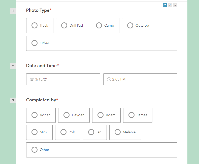

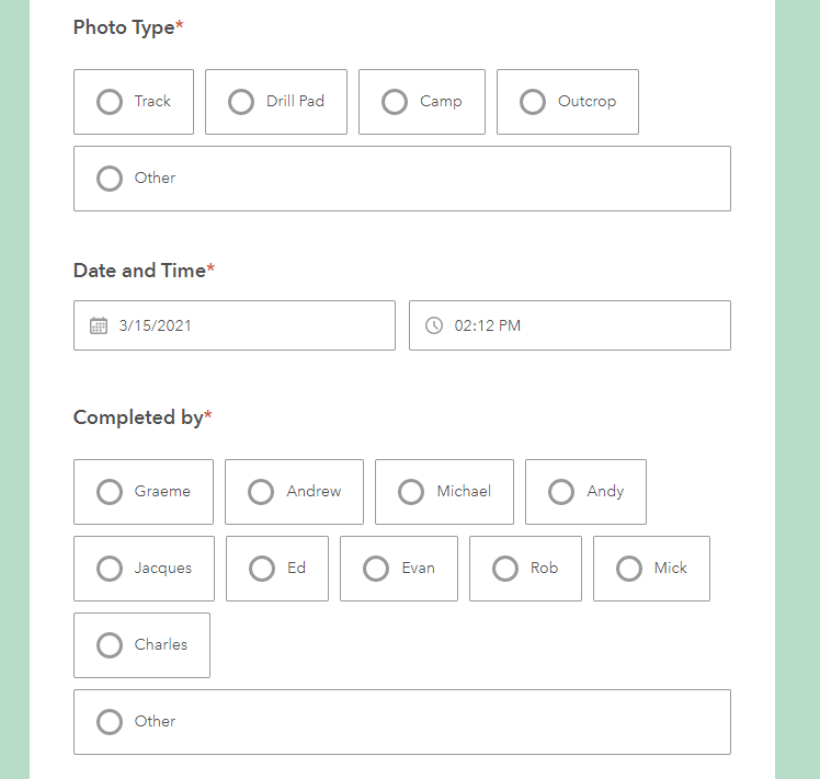

Hello,
I have designed a survey using the web designer. One of my colleague wanted to modify it and use it on another site so I created a copy of that survey and then changed to ownership of the copy to my colleague so he could make the changes he needed.
He renamed the survey and made the changes he needed then saved and publish the survey. When he downloaded the survey onto the survey 123 app, he could see the changes he made on the survey form however when he opens the design survey on the web designer, the survey has reverted to the original question that were present in the copy.
Web Designer Survey Questions
Survey 123 Form Questions
Does anyone know where the problem lies and how the get the design part showing the same questions and answer than the form part?
Regards,
Melanie

And no that is not the case, no change was made to the survey after being published without being re-published. The issue is that changes on the survey were made, then published. Those changes can be seen in the published form that is accessible on mobile. However when the design page for the survey on the Survey 123 website is re-opened after publishing, what is shown is the initial survey without the changes that have been made and published. It goes back to the initial survey.
Regards,
Melanie
