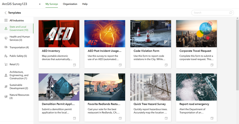

Survey template gallery in the web designer
With the Survey123 web designer you can easily create your own smart forms, visually and from your web browser. The Survey123 web designer is a great starting point for anyone who wants to quickly put together an online form. This update introduces a new gallery of survey templates to help you get started with some pre-configured designs. You can use these templates as they come or modify them to suit your needs.
The Esri templates are categorized by industry. We will progressively add new templates to this gallery.

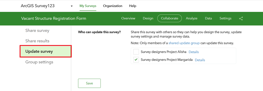

Allow others to update your Survey123 web designer forms
For smart forms authored from the web designer, you can now grant other members of your organization permissions to update your survey. In this way, you no longer need to transfer ownership of your survey for others to work on it or maintain it. To grant others permission to update your survey, you simply need to share it with what is known as a shared update group.
Conceptually, a shared update group is a group where its members can modify items in the group, even if they do not own them. Only the owner of the item can delete the item and change its sharing, but other aspects of the items can be modified by anyone in that group.
Here is a list of a few important things members of the shared group can do:
  • Change the survey design with the Survey123 designer. This includes things like adding, removing or updating questions, re-organize questions in the survey with groups and pages, changing the survey theme and the Thank You screen. In short, anything you can do with the Survey123 web designer.
  • Create, change and add new webhooks. This includes automations from Integromat and Microsoft Power Automate as well as custom web hooks.
  • Upgrade a survey to the latest version.
  • Modify existing report templates.
  • On the Collaborate tab, close the survey or schedule the closing date as well as modify the closing window, change access privileges to the survey or survey results.
Here are the things that members of the shared update group cannot do, unless they own the survey:
  • Delete or move the survey
  • Delete the survey
  • Add new report templates.
  • Change the scope of sharing. For example, adding or removing groups from sharing.
To use this capability, you must first ask your administrator to create a shared update group and invite people to it. Once you are granted privileges to share to a shared update group, open the Collaborate tab of your survey and activate the Update Survey section as shown below.
The list of shared update groups will show in the right so you can share your survey accordingly. If the list is empty, that means that you have not been granted privileges to share items with a shared update group. You will need to contact the  administrator at that point.
I want to emphasize that this capability is only available for surveys authored in designer. Survey123 Connect does not yet support shared survey ownership.  Additionally, please be aware that it is not a good idea to have two persons editing a survey at the same time. This is because the survey design is not locked to a single user and there is no conflict resolution logic. If two people edit a survey at the same time, the last one saving edits wins! That is just like saying that the changes from the first editor will be lost. This feature is not about collaborative design of surveys. This is more about allowing different people in a group to perform maintenance and occasional changes to a survey as needed.

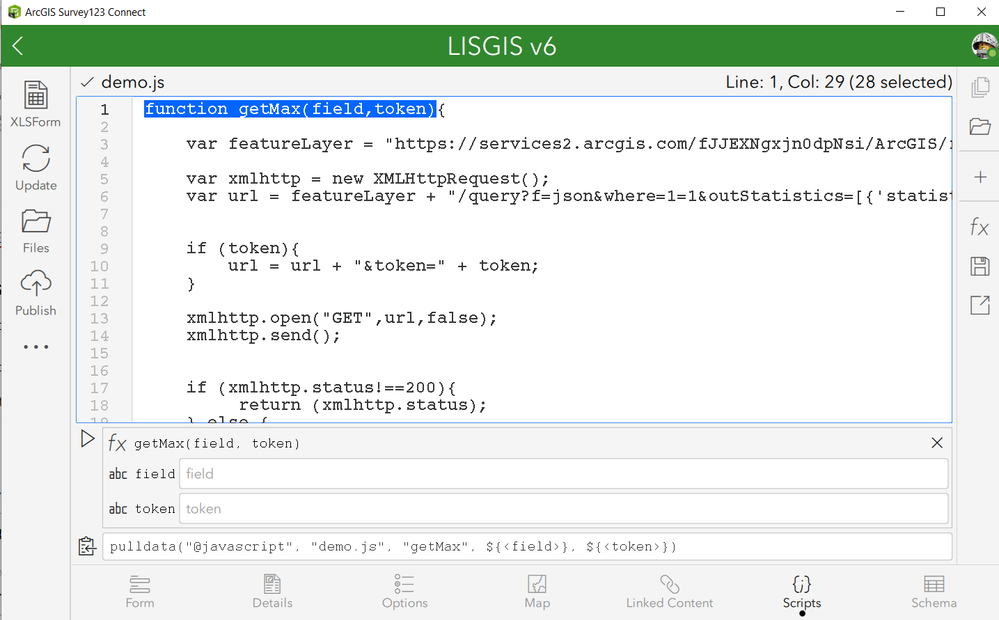

Custom JavaScript function utilities in Survey123 Connect
In our previous update we introduced the notion of using custom JavaScript functions to complement XLSForm expressions. JavaScript functions offer flexibility for handling complex logic that is otherwise difficult to implement in XLSForm
With the 3.12 release, you will now find a new Scripts tab in the bottom bar of Survey123 Connect.
Writing the actual code does not get any easier, but there are a handful of nice features in the Scripts tab to make your work simpler. First, you no longer need to create the scripts folder manually: By adding a new JS function on the Scripts tab, Connect will place your code where it belongs. You can test your code right from the Scripts tab and also copy the corresponding pulldata() function call you need to insert in your XLSForm. You can also launch your script in your favorite developer IDE.
Learn more about the Scripts tab in our help.
