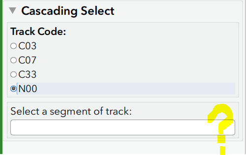

Hi,
I am not sure what I'm doing wrong here but I am having issues with Cascading Select. I have tried changing autocomplete to minimal, but it still doesn't made a difference
My survey setting:
My choice sheet:
I am not getting the result I'm expecting - unable to select segment:
Please advice.

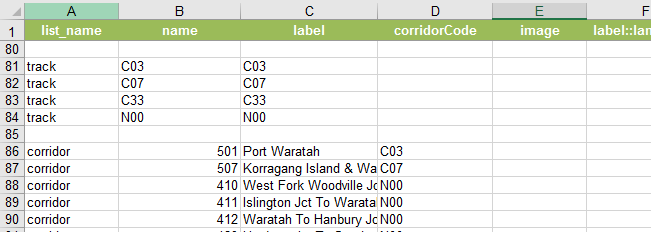

Siew_WeiGoh2
Worked out why my Cascading Select didn't work!  So it's working now once I changed the column header in the choices tab from "corridorCode" to "state" (Column D). This suggests that there are set lists of column headers one has to use when utilising additional columns in the choice tab. Is there a specific lists, listed somewhere?

SMauri
Hi, double error I can see.
  1. Column D name must be the same of list name "track"
  2. Choice filter you must like this one:
    Track=${track}
More info here: https://community.esri.com/groups/survey123/blog/2015/10/22/cascading-selects-and-external-selects

Siew_WeiGoh2
Hi Stefano,
Thank you for pointing out my errors. I have tried the modification but am still having trouble for the cascading select to work.
Survey tab:
Choice tab:
I've modified the structure of my form slightly by using 'calculate' instead of 'select_one' to grab the the 'track code'. It should work since it's returning the correct track code (row 28).
I'm struggling to see where I stuff up!
SW
SMauri
Look at this very simple Excel...and tell me if I understand what you need.
Stefano
Siew_WeiGoh2
 Yes. Your XLS is what I need.
I copied the relevant sections into my XLS form BUT it didn't work
I then tried my formula on your XLS sheet and guess what... it worked!
I even test changing Row 8 to 'calculate' and 'note' and all of them worked on your XLS form.
This is bizarre. It is not the first time I had issues with the Cascading Select function not working as expected. Has there been any report on buggy cascading select?  Unless I am still missing something... I'm suspecting there is something that is buggy with my XLS form?
 - Any suggestion on what's next or how to fix?
Thanks SW
Siew_WeiGoh2
Ah! YES!!!! I've found the source of the problem!  - *where's the sweaty forehead emoji?*
I had some empty cells in the choices sheet on referenced column D on the cascading select which tripped the all the cascading select function on the form. Once I deleted these empty column D rows.. the form works perfectly!
Another lesson learnt!
