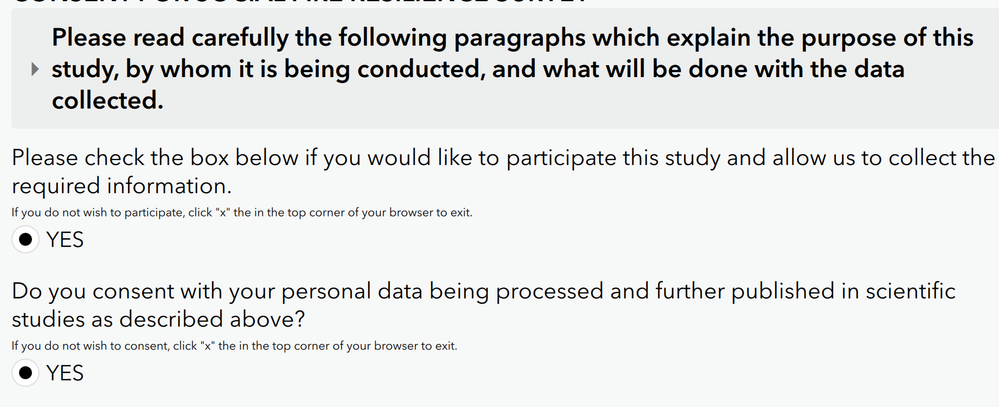

I am doing a survey that is planned to be launched online. In the first page of the survey I added a consent section where the person needs to click "yes" in two select_one type question in order to continue to the following pages with questions. Otherwise, it will automatically send you to the last page of the survey (See pic below).
The problem is that in a pre-test group, four of 25 people had the problem that after clicking in both consents it did not show the survey, instead, they were sent to the last survey's page, which is not supposed to happen. This happened to people of a variety of age (20 to 60), and different device users (android, ios and windows). Therefore, I have not been able to find the error. The code I have used in the "relevant" column is the following: selected(${consent1},'c1_Yes') and selected(${consent2},'c2_Yes').

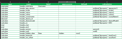

As for the survey not dynamically showing for some people, did you collect any metadata? Could potentially be:
  1. Browser issue. That's a large age range, so I would assume a diverse userbase. Comparing their set-ups could shed some light on the issue. I use the following to collect metadata in all surveys:

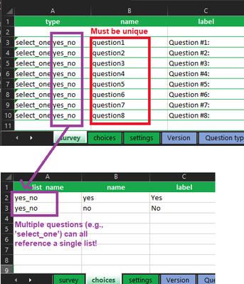

abureaux
MVP Frequent Contributor
They sure can!
All that really matters is that each of those 'select_one' questions has a unique 'name'. Survey123 will give you an error if you have duplicate names (as illustrated below).
#1: Conditional formatting in Excel. This can break if you copy-paste things wrong (always use 'paste values only' in Excel)
#2: Error converting XLSForm popup. This appears when you try and save the document with a duplicate in the name column.
#3: I believe they fixed this one... In the past, I have had someone able to hide the first two errors. They tried to publish the survey and got a very strange publishing error.
